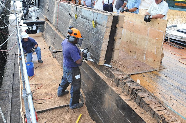

Nachrichten über den Umbau der USS CONSTITUTION
Der Umbau und die Reparaturen an der USS CONSTITUTION fingen in 2007 an.  Das Schiff wird während dieser Restaurierung zum Stand von 1812 umgebaut.  Einige Eingriffe sind ziemlich massiv.  Das Schiff wird beim 200. Jubiläum des Krieges von 1812 (USA vs. GB) in 2012 wieder in USN Dienst gestellt werden. In 2014 geht es ins Trockendock um die Kupferung zu erneuern.
SlideShow: http://picasaweb.google.c...eshow/5476049896846376210
 Hoffentlich sind die Pläne historisch korrekt!
Vom USS CONSTITUTION MUSEUM Newsletter:
Keeping you connected to USS CONSTITUTION
   September 2010
Update! Restoring "Old Ironsides"
On September 14th, the final and most visible stage of the 2007-2010 restoration of USS Constitution began with the cutting open of the port waist bulwarks at the spar deck level.  Approximately 40' of the upper port bulwarks, flanking the main hatch, were cut away in four sections.  After Constitution's October 21st underway cruise in Boston Harbor to mark her birthday, the starboard waist bulwarks will be removed.
Each 10' section of triple-thick bulwarks - white oak exterior hull planking, live oak framing, and white oak or Douglas fir interior planking - weighed approximately 2100 pounds.
After the waist bulwarks was cut away and before the oak "cap" was installed to cover the exposed live oak framing, the new hammock irons that will be installed in this open space were mocked up to make certain that the angle of the irons was set correctly.  When completed, the oak cap will cover the live oak frame ends, six hammock irons will be bolted in place, and netting will be strung between the hammock irons. This open area of the ship was intended to be the "cargo bay" of Constitution.  Here the guns could be lifted in and out through the main hatch, as well as the enormous casks of water, food, and the other tons of equipment that were necessary to maintain a 500-person warship such as Constitution at sea for up to 9 months at a time.
Photos courtesy: Naval History & Heritage Command Detachment Boston/James Almeida

So wie es ausschaut, wurde nicht viel an der Struktur gemacht sondern nur etwas renoviert
Der Umbau war ziemlich massiv und nicht nur kosmetisch.  Das ganze flache Deck wurde abgerissen und wieder mit neuen Balken gewölbt und verstärkt so wie es ca. 1812 war.  Im Mitschiff  (waist) wurden die Bordwände  (bulwarks) herausgesägt.  Die Bemastung  (Epoxylaminatholz) und Takelung sind zum Großteil auch neu.  Das Schiff wurde um 35 Tonnen erleichtert.
PS:  das einzige originale Stück Holz im ganzen Rumpf ist angeblich nur der massive Kiel  Matrose lacht laut
