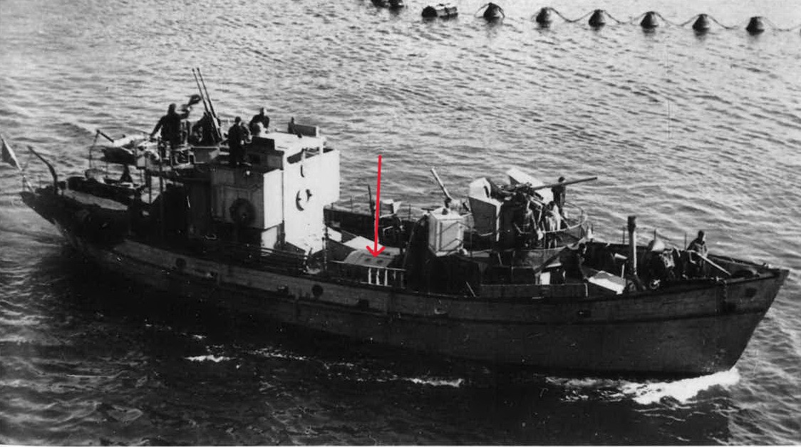

Today I happened across a photo of a KFK built by the Dutch shipyard Enkhuizer Constructiewerkplaats. As luck would have it this is also the shipyard where KFK 55 was built. This site also has a pic of an MFP which was also built here. Also of interest the schwere Sturmboot 42 which probably belonged to the Wasserschutz Polizei. I posted several other pics of this vessel here some years ago.
https://www.strijdbewijs.nl/enkhuizen/enkhuizen.htm
By the way, last week I noticed that three KFK's of 36.Minensuchflottille had received an armored bridge. KFK61 had received one in Brügge on 30.08.43.  KFK 51 and KFK 238 also received one in the summer of 1943 in Rotterdam. I wonder why these three boats received this upgrade whereas the other vessels in the Flotilla didn't.

Today I discovered that there are KFK line drawings on the Gusto shipyard site. What strikes me is that the skylights have the same portholes one can see in the photo of the Enkhuizen KFK. These skylights with portholes are also present in some other pics of KFKs which made me think these may also have been built by Gusto . I know that at least two of Gusto built KFKs were destined to become Hafenschutzboote (Boulogne and St.Nazaire)
https://werf-gusto.com/kriegsfischkutter/
Definitely looks like a Hafenschutzboot to me :
edit: What puzzles me is that we know that KFK 55 was built at the Enkhuizer constructie werkplaats and this vessel had the "normal" skylights with the protective steel bars. Yet the 1945? photo of Enkhuizen shows a KFK with skylights that have portholes instead of glass window panes with bars. So perhaps the later version is a change in the design to speed up production ?
