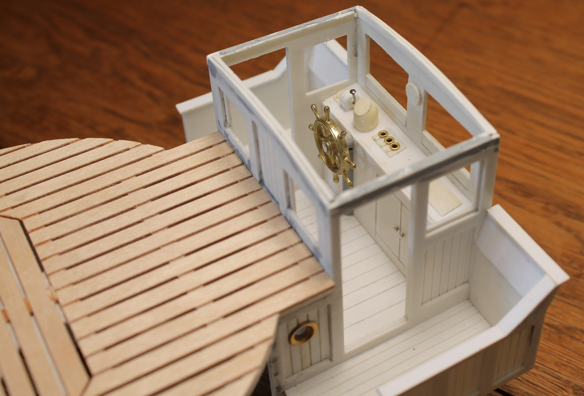

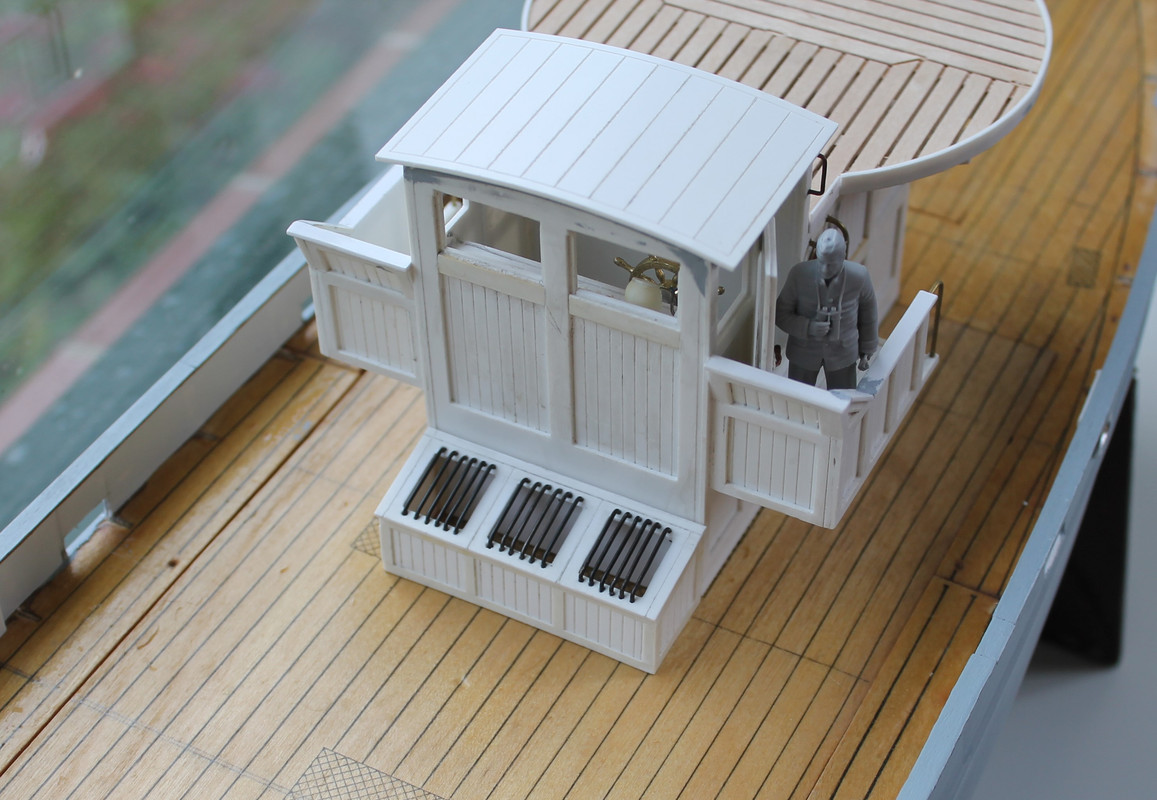

Some pics of my progress so far. I bought some 1/35 KFK parts at Wikinger Modellbau but on the whole these are rather disappointing and require much work to make them more accurate. I haven't glued the various parts on the deck for ease of painting later so they may not be aligned perfectly in the pics I've made.
The 1/72 Special Navy model kit I use for measurements is quite accurate and the biggest mistake is the door on the port side of the Kartenraum. In reality the chartroom only had one door on the starboard side. I removed the  incorrect door and replaced it with some polystyrene parts I made :
My 1/35 build :
To be continued.
